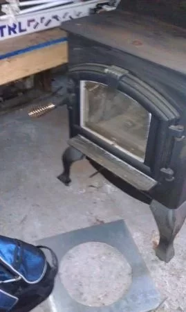

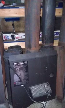

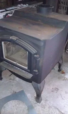

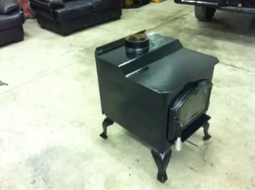

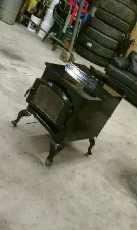

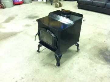

Indoor wood stove - $350
Magnolia wood stove. Heats 1800-2400 sq ft home. Free standing cast iron. Glass door. Fresh coat of high gloss stove paint. Was used in my home 2 seasons. Has an external blower. $350.

The Mag should do the job if in good shape. But that paint job makes me suspicious. One is why did it need it and two that does not look like stove paint.
Agreed with BB. Another note...the only things cast on that stove is the door and maybe the legs. The body is plain ol steel.
I was thinking the exact same thing, called but didn't get a hold of anyone yet ,to ask more questions.
Is there even ! high gloss stove paint available ;?
May be but I ain't ever seen it. I get a mental image of a break-in fire in the living room and a whole can of Rustoleum on the stove catches fire. !!!
That paint job don't look right.....
But the stove if it is in good working condition is a great stove it throws some massive heat with good dry fuel. I can get 8 hours burn time and it hold coals a long time.
