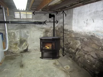

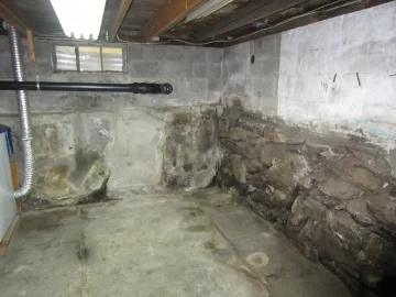

I was planning a pellet stove install for my basement this month but after seeing my basement they declined the install because of my un-insulated basement, along with a partial fieldstone as well. It was going to be nearly $4000. installed, including taxes venting and installation. I'm looking to heat 900 sq.ft. just the basement, my Fireview heats the entire first floor and our bedroom on the second floor. Does anyone have an idea of what a class A chimney for a wood stove cost in the Massachusetts area? I figure about 15' of pipe running on the outside of the house, exiting the foundation and straight up the exterior wall above the roof. I was thinking a pellet stove for the ease of heating the cellar but maybe a wood stove would be a better choice? I've got a friend of mine that heats an old un-insulated farm house with a cheapo home depot wood stove, so I figured I could heat my cellar? I am going to spend the winter parging the rest of the fieldstone and framing and insulating the walls the best I can but I'm sure a wood stove can heat the cellar without it? I'll upload a picture of the corner of the cellar where I plan to install the stove.
[Hearth.com] Class A chimney Install
And here's my photo shopped picture of the QuadraFire CB 1200 that was going to be installed there....

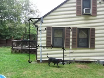

Thanks begreen, nope, no soffit to go through. Straight out the foundation and up the outside wall. Here is a poorly photo shopped picture of where the chimney will go. This was for a pellet stove install but you get the idea. I'll have to go higher with the pipe than pictured.

That is going to take a lot of pipe above the roof edge to be code compliant. The top of the pipe has to be at least 10 ft away from the roof surface (measured horizontally). I would guess it would end up being 20ft of pipe plus bracing. That is going to look like crap IMO. I can see why you were thinking pellet stove. It would be relatively easy to install the piping yourself in the indicated location. True, with the uninsulated walls you are going to lose about 1/3d of the btus, but that will be the same with a wood stove, gas or electric heater.
Reactions: dylskee
Damn, I was afraid of that! You're right though, 20' of pipe would not be what I'm looking for. Heating this basement is going to be a challenge!
I wouldn't be deterred by one pellet stove dealer's opinion. As long as you know the caveats going in and are not going to bug the dealer over heat losses then that is your problem (and incentive to insulate asap). Just figure on the loss until you insulate. You will use more fuel, but on high the 1200 should be able to heat the space. We had the CB 1200i and it was a good heater. Even if you realize only 32,000 btus/hr. the space should warm up ok for all but the very coldest days.
PS: It could be the real deterrent was cutting a hole in the wall for the vent and digging a proper well on the outside. Would you consider installing this yourself?
