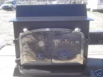

jnthuskers,
This your stove?
  • [Hearth.com] Class A chimney pipe
No, I bought the Kozy Heat 234 model. It calls for a 10" double wall or clay flue. I'm going with the double wall, figuring that I will save money in labor alone. Not that I am being cheap, I'm just looking to save as much money as I can. I know that I have to use one of the these (simpson , selkirk , duravent or some other brand). I just don't want a $3500 job turning into a $5000, $6000,or even $7000 job,for example. I know, I will recoup the money spent in time. My house is well insulated with BIBS. I watched the insulating contractor do my entire house. Nit picking every SQUARE INCH. I really was a pain in this guys (FOUR POINT OF CONTACT). I have great windows and doors, in my opinion.
