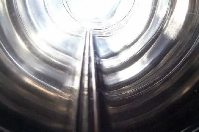

I believe that I have attached the photo. The small gap at the top right of the seam is what I am talking about.

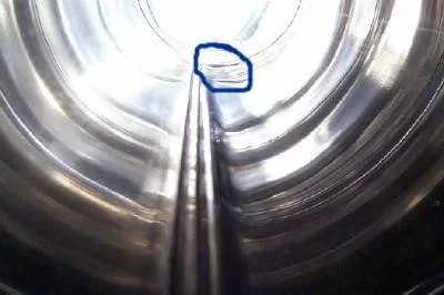

HEY ! Somebody let me borrow there glasses ...............Me cant C . is this what your talking about ?

Yes sir, that's it. I can stick a coat hanger up under that section.
In my opinion ( worth about .02 cents ) i would just give it a tap if you can other wise i wouldnt worry too much about it , i would think it will fill in. Lets C what other have to say first.
I want to make sure "I'm" straight ....... This is Class A insulated lock togother pipe? right? So the male ends are going up with the female ends locking on top of it. So if a spark was to go through it would have to go up .... over ..... and then down to get out of the locking joint.
In answer to Roospike, yes it is a male female locked together class A pipe
Looks like a few taps with a hammer would make it perfect. I dont see how it would hurt anything the way it is. Thanks for posting the photo.
