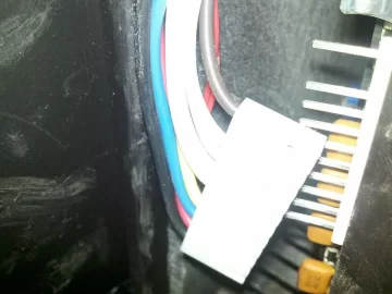

A customer I sold a Harman Accentra to a year or so ago paid a "chimney cleaner" to clean his stove. I was unable to do the cleaning due to time and distance. Well the customer calls me and says the stove was cleaned a while ago and this is the first time he went to fire it up. When he went to turn on the stove nothing happened. Hmmmmmm.
I arrive at the house and see no power light lite. I open the stove up and what is this that my left hand is feeling. It is a disconnected molex running to the rear of the control board. In the stove business this is known as a "clue" to the problem. I connect the molex to the board and almost instant heat and a happy customer.
