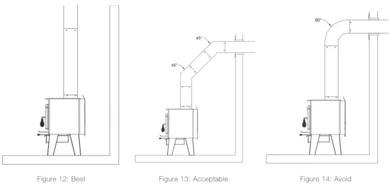

It sounds like the draft may be marginal though sufficient to get a good burn going. Bathroom fan(s), windows open or leaking upstairs, clothes dryer, combustion appliances (gas hot water) could also be competing. This could be improved by changing the 90 elbow to two 45s with an offset. An outside air connection might also help, but that may be difficult in this situation.
