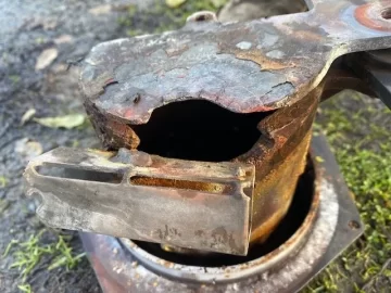

Do you have a picture of this hole that was burnt in the firepot floor? That’s something I’ve never seen.
I dug it out of the scrap pile. It looks just a little larger than it is because I set the old floor on top of the new one. I was rather alarmed when I saw this, but looking online- there was some indication that 3 years was how long a firepot should last and this stove is 10 years old. This is my first pellet stove and I suspect I may not have cleaned the pot often enough.

Wow mine is 20 yrs old and is nowhere near that bad. Thanks for posting the pic. :)

Yep,Ssyko,still many old pots running here. But,is he original owner,and(the biggest thing,I think,) was the stove cleaned in spring,and protected from moisture? Summertime rust has ruined many pellet and wood stoves,from being left dirty. Oh,hiya!!
So true so true brotha bob. ;) I couldn’t even count the cans of fog oil I’ve used over the years. Oh yeah hiya lol

Never seen a 1200 pot floor get that bad... mine is 10 years and running strong. I’ve seen plenty of 1100s from the 90s with original pots as well.
