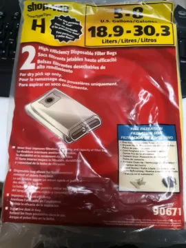

Same here. Bought it 5 years ago and still haven’t had to change the filter. Just knock off the ash with the plastic pickup tube. After the stove shuts down I run the exhaust blower with the damper wide open, that cold outside air cools the stove pretty quickly. Never had any hot embers.Shop-Vac with drywall dust bag
same here. Drywall (yellow) bag inside. I soil the deck a couple times every winter. The black stuff looks good on the snow...I hide a metal canister shopvac 6.5 hp with a fine filter and bag, I also do the leaf blower trick after every ton or so

IMO, ash Vacs are for wood stoves and fireplaces where there may be hot embers under the ashes that stay hot for a long time. That isn't so with a bio mass stove. The pellets burn out quickly with forced draft, same with corn (takes a few seconds longer). My Shop Vac (stainless barrel) came with a really long cord and casters which is nice when vacumming the shop as One outlet is goof for about all of it. The largest Harbor Freight cannister vacuum is a good alternative and costs about 50 bucks less than a shop vac. Problem is, it has a plastic barrel. I have one as well. Got it for a Christmas present. Takes genuine Shop Vac yellow drywall bags too.
You have to use the yellow bags versus the white ones. The yellow bags filter much finer and are meant for sheet rock dust.

What did you end up using and have you been happy with it? Or is it all just a lost cause and may as well stick to bucket and shovel?Thanks for all the good advice. Rather than use my 5.5 gal. Shop Vac I believe I'll look for a 3 gal metal shop vac and use double filters.
