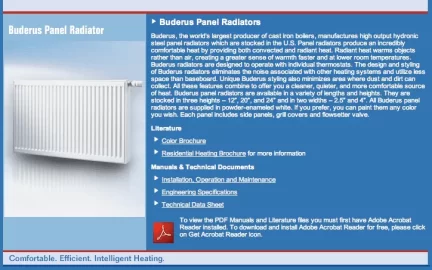

Are you referring to old school radiators?
sort of.
Panel rads are generally a stamped or welded steel. They work on convection but also the warm flat surface is much like radiant. They run nicely on 140-160F or lower supply. Easily zoned, plenty of sizes and colors. Many installers feed them with 3/8 or 1/2" pex tube.
Some double as towel warmers in bathrooms. Quick response makes them nice for bedrooms with night setback programs.
Google panel radiators to see many brands and styles.
