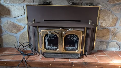

My wife and I recently bought a home. This will be our first winter here, and we had no idea about this prior to purchase, but our wood stove doesn't even have a trace on the internet, and we don't have a manual for it. According to another post on this forum (and the only other person I can tell that has one) it's from the 80's. We had everything inspected and cleaned and they told us everything passes and it's fully usable, so we wanted to give it a go this winter to try to offset the cost of heating. Electricity heating looks like it would cost us $300+/mo for Dec/Jan/Feb/Mar, so I turned to our wood stove to see if it could save us some money.
The problem is, it seems to be pretty inefficient, but maybe I'm the issue. I ran it yesterday for the day to try to learn how to operate it optimally and ended up burning through about 1.6 cubic feet of wood (19 split logs) in the span of about 8-10 hours. This seems super inefficient to me, as I had to add a couple more logs every hour. I even tried to add 5 at a time and it still only burnt for a single hour, just hotter. My strategy was to let it combust, then I would cut the air intake back to virtually nothing, sometimes even completely shut, and closing the flue to about 3/4 the way closed.
For reference, we live in Canada, it's relatively cold where we live (Montreal). We're able to find a face cord of wood here for ~$120 (fun fact, they just call it a cord here, and it's the only way people sell it). I'm really at a crossroads, do we just tough it out and use electric heat this winter and save up to replace it, or do we use it occasionally to offset the cost of the electric heating? I'm leaning towards the latter. I wanted to only use wood heat, but it's so inefficient compared to the newer wood inserts that I just can't bring myself to waste that much wood.
Is there anyone here that has advice for us in this situation? I need to buy wood now if we're going to go this route, and I'm considering 4 (face) cords, just to help us heat a little during the day/evening during the winter. Also, I've attached a couple photos of the fireplace.
Edit: I should probably specify that our house is 2 stories (basement and main floor), about 2,000 sq ft, and the heat from the fireplace does pretty well at getting up to the main floor.

1.6 cubic feet in 8-10 hours isn't a lot. It takes a lot of BTU's to raise and maintain temperature in that much square footage. I have a 3 cubic foot stove and can easily fill it 3 or more times a day trying to heat 2500 square feet. My typical annual consumption is about 4 full cord (1 1/2 - 2 low BTU & 2 - 2 1/2 hardwood).

Wow! I guess it seemed like a lot to me because I was low key hoping it was possible to heat with a lot less wood. I keep hearing about people able to stuff their stove and have it run for 16+ hours. By hour 3-4 without feeding mine, it's mostly just a few embers.
Maybe 1 1/3rd cord isn't enough for us for the winter.
Montreal has some cold winters. It could take 3-4 cords to heat 24/7 there. I'm a bit surprised they allowed this old stov to be used because I had read they have very strict guidance on wood burning there.
The new stuff, depending on how it works can definitely get long burn times at low outputs. BK folks (catalytic) can get 24-36 hours on a single load at low outputs. Higher outputs reduce burn times. My secondary combustion stove can't do that, but it's way better than my old smoke dragon.
It looks similar to a country comfort or an Alaska cat stove from the late 90s. They weren't bad stoves at all. Does it have a cat in the front above the door?

We use 4-4.5 full cords to heat 2000 sq ft in northern Ohio...3-4 "face" cords might get you some evening and weekend burning...and good luck buying wood that is ready to burn this year. Everybody advertises "dry" or "seasoned" wood, but apparently dry means it hasn't been rained on in the last 24 hrs, and seasoned, well, nobody knows what that means in relation to firewood...when I season my food that means salt, pepper, maybe some garlic, dunno why that would benefit your firewood though.
If you buy wood that hasn't been cut split stacked for a couple summers at least, it isn't ready to burn, unless it's been kiln dried maybe...and you'll pay a premium for that.
Burning wood that isn't really dry is just an exercise in futility.
You will figure out the best way to heat your home it just may take some time and experimenting, and have found the best community on the internet.
Don’t jump in and buy 4-6 face cords right away (it’s probably not dry enough anyway).
My recommendations buy a moisture meter. Buy a small amount of dry wood and see if you like using the stove. Depending on what your electric rates are buying wood may or may not be cheaper than a heatpump.

No cat, there's just a flue that never really shuts all the way.

my opinion , your stove is an insert, it may or may not have a blower on it or in the surround. This limits amount of heat radiated in to the home. Wood that is insufficiently dried ( in excess of 20% moisture content) expends most of contained btu's drying out the excess wood moisture content. For this season I wood recommend obtaining compressed wood blocks which could be used in conjunction with the wood splits or stand alone. Moisture meters are of 2 types pin and non pin, The non pin is simpler to use. Note that in ether case the split being checked must be at room temperature and just resplit to read the internal moisture content.
