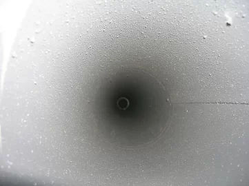

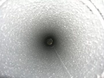

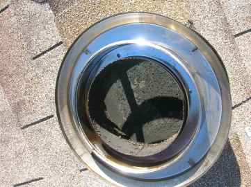

Swept the chimney this morning and had a couple surprises. One good, and one that kinda irks me
I have a new install and do not have any decent wood to burn. Been surviving on pallets and using them to ignite the not so dry wood. The pallets light easy but make the windows black. Pine?
Anyway, after reading about the way most peeps windows stay clean and how easily creasote builds up if u use bad wood I was expecting the worst.
It wasnt so bad. I got about a cup and half of coffee grounds out of the 12 feet of pipe. The cap had some signs of the sticky nasty kind but none in the pipe
The bad thing was that the brush seemed a little too small. at some locations I had to push sideways to feel like I was hitting it hard enough. For the final swipe I wrapped a Tshirt around the brush and put it through.
If you read people on here talking about their brush they say it is too large and they have to trim it.
I have the 6" heavy duty poly brush from Northline express (broken link removed to http://www.northlineexpress.com/item/5SB-34806M/6-Round-Pro-Sweep-Heavy-Duty-Poly-Chimney-Brush-34806M)
Anyway... I feel really good about the chimney now but still kinda bad on the brush. Is your brush easy to put in your chimney
First pick is from bottom - up
Second pic is from Top - down

It wouldn't look like that if it were an exterior masonry flue here in the north east.

Nor would it if he added another 12' to the height. Most of the creosote is leaving the shorter stack while the gases are too hot to condense onto the pipe. Which, of course, is a good thing. Even with my interior chimney, 25' of clay tile gets defeated before the gases hit the top no matter how hot I burn, so there will be deposits way up high, that's for sure.
