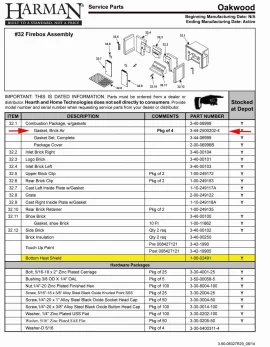

We had a break in the weather yesterday and I pulled the CP out to clean. Mine was stuck to the rear housign. Some material broke off but I don't think it would impede its performance. To my surprise, there wasn't a lot of ash. However, the two square gaskets at the bottom of the combustion chamber were very brittle and fell apart. I had a fiberglass sheet and made some new gaskets but I would like to order a couple to keep on hand. Is part number 3-44-2500202-4 the part number for those gaskets?

I don't think so. I think that is for the small square upper front brick gaskets. See the link below for some pictures of some of the gasket sets.
