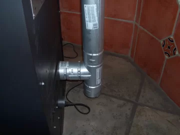

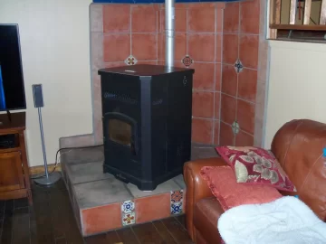

I have a PelPro PP130 and the exhaust vent thru the roof. I'm having trouble finding something flexible but firm enough to clean the vent from the botttom. I'm soon to be 74 and really don't need to be on the roof. What's everyone that has a situation similiar to mine doing? Attached are photos showing my situation.

Its hard telling from the picture how much room you got from the floor to the tee. I got about a foot.
