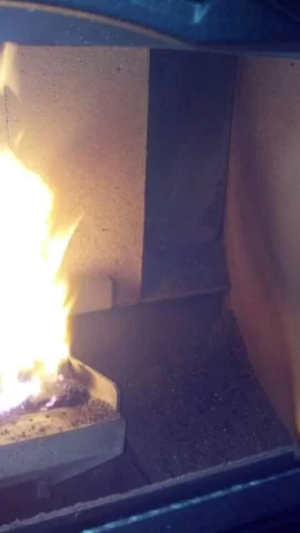

Having said that though, I have to admit that I have gone 12 days since I did my "weekly" cleaning. Stove looks filthy. I'll try snapping a pic.
Pic with my phone of the side shelf and fire brick ledge on the side. Real dirty... Been burning mostly in room temp manual and been in Maint. Burn for long periods of time.
That looks like my stove after about 4 days.
