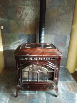

Good goinf @Lake Girl !
That is a nice looking stove and a nicely decorative hearth pad and backer board; someone put some time into that.

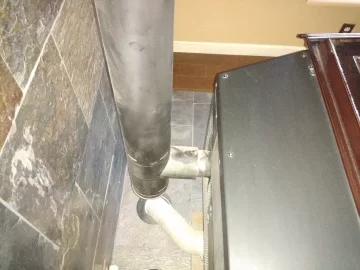

If you can, take a pic of the back of the stove. Let us see if there is a clean out T on the pipe. We might be able to help you with cleaning the chimney yourself. kap
You may find that there is a small indent notched in the plate that shows next to the correct model (or a small dot). If it is there, you may need to use a flashlight and various angles to eventually tell where it is.
Thank you. The stove was already in when we bought the place two years ago.

Is there a cleanout at the bottom of the pipe? If there is, you can clean it from inside the house. Let us know. And if you hire a chimney sweep, wath and learn, so you can do it yourself. And sure is dusty back there. Looks like pellet dust? And yes, you can buy the orange re-useable gasket. kap

I hate to say it but im not exactly sure what a cleanout looks likes. There is a grove that goes all the way around the pipe about an inch from the bottom and looking at it it looks like it may pop off but I do not see any screws that hold it on, so Im not sure.
It's not pellet dust but I wish it was. I live in the Nevada desert and dust is a issue here and we have a few days a month with high wind warnings which aggravates it. I lived the last 30 years in a concrete sub-division in California and we had dust there also but nothing like this. We can dust three days a week and it's not enough. Now that we are heading into fall and winter the dust will get better. We just had some rain and then helped a lot but it really is a pain here. I guess the trade off is that it's secluded and quiet.
Most clean outs twist in. Are you able to ask the previous owner if there is one? And it sounds like a good trade off to me. kap
That is a cleanout at the bottom of the T. It can be a PITA to remove, but it will come off - twist it counterclockwise and then pull - it won't come off like a bottle cap and you may have to "rock" it back and forth until it comes loose. When I reinstall mine, I tape it over with hi-temp silicone tape because that is a place that tends to leak smoke at start up.
