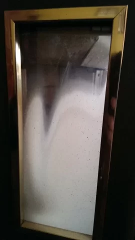

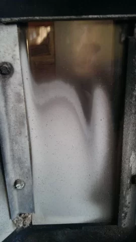

My glass really never gets black, more gray, but on the side windows. I use cinch or this Windex vinegar spray or even sometimes just a moist paper towel.
I just shut it down to give it a quick empty/ vacuum and took some pics of how my glass gets.
