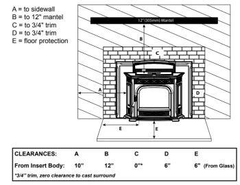

I'm thinking of buying a Harman Accentra Insert for installation into an existing masonry fireplace. All of the dimensions seem to work out except one: D specifies 6" from the stove body to 3/4" wooden trim. My trim is 1.5" deep, how much clearance do I require?
[Hearth.com] Clearance for deep side trim
What is the distance to the side trim? Does this insert have the cast iron surround?
It's best to ask Harman support if they have this information.
