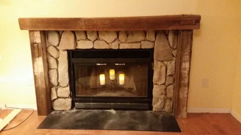

Hey everyone
I am redoing the zero clearance wood fireplace in my living room with some old barn beams. I don't actually use fireplace, but I want to ensure that what I am doing is code or safe. The barn beams are from the early 1800s so the moisture content is low and I am not resurfacing them at all. There was wood trim previously around the fireplace, but it was lower profile. Thanks

Thanks for all the help. I couldn't make out the exact model number to I just decided to bump everything out to ensure I exceeded any code. Here is a pic:
