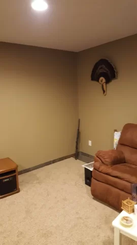

I was reading through the manual off Blaze Kings website for my Sirocco 30 (that has not arrived yet) but didn't see, or overlooked clearances for the front or sides of the stove. What is the minimum clearance to a couch if the stove is placed at an angle in a corner?

The manual say to keep furniture and such 48” away from the front of the stove.
