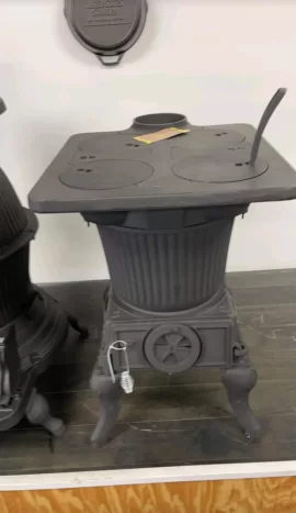

So my dad brought us this .. Vogelzang? USSC?
Anywho- it's cast iron I believe. And we're planning on making a hardy backer surround (for now, until I can get stones to add on) but .. does it count as clearance to non-combustible? Manual says combustible clearance must be 36 inches, but that takes up so much of my corner, I'm hopeful we can cut some of this off?

The Hardy Board does not lower the tolerance requirement. The 36" would be from the studs to the stove, regardless of the backer board. Only option would be to swap studs out for steel studs (and even then you'd be measuring to the sheathing or drywall on the back side, so you'd only be gaining 3.5") or heat shield. I believe Heat shield is some type of metal or non combustible surface, offset from the wall by an inch or two to provide air flow behind it. This does not cut clearances to zero, i think it cuts them in half, or something along those lines. Someone more experienced than me should be able to provide those specifics.

A proper ventilated heat shield will cut clearances by 2/3.
