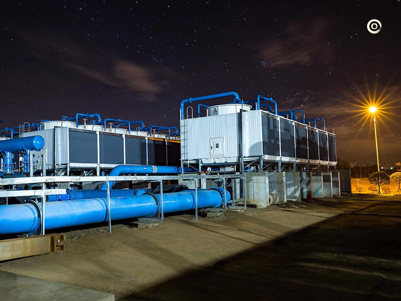

Google is partnering with EnergyDome in the deployment of this alternative to chemical batteries in solar installations. The goal is to provide 24/7 carbon-free energy. It looks like a simple, relatively low-tech and economical process based on globally available resources. The first 20 MW / 200 MWh Energy Storage project is now operational on Sardinia with future projects planned for India and the US.

I think the CO2 balloon is HUGE. Like Hindenburg huge. So, basically, you build a (cheap) rigid tent the size of an aircraft hangar, and have an inflatable balloon for the CO2 that you can inflate and deflate inside. My guess is that that is a major capital and maintenance cost.
I would think that you could run the gas side at slightly elevated pressure (like a few bars) without much loss in kWh/ton CO2, and maybe use a geological reservoir for the low pressure side (like a cave or a salt dome). The problem I see with that is that the CO2 probably want to be kept very pure/dry so as to not gunk up the machinery with ice? And free geological reservoirs are rare.

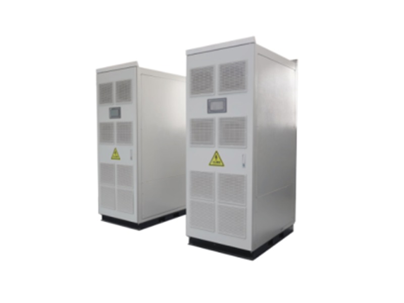

I wonder if these supercapacitors are any good. They work on DC, so you would think it would match solar.

Liquid is nice because high density (so less storage space needed - but they then need this gigantic tent (see the pics) whereas for air we use the atmosphere for that part ...
If you use the same total volume of real estate for storage of compressed air, how does the energy/volume compare with this footprint?
