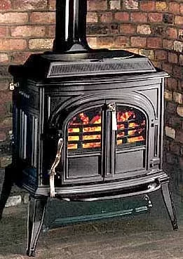

Vigilant Coal (hand fired)
C. Lighting
Initiating a coal fire in this type of stove can be difficult because coal is hard to ignite; however once a fire is established a batch fed coal stove can run continuously from the beginning of the burning season until the end. Below is a method of starting a coal fire which generally works very well, however individual stoves vary, so this procedure may have to be adjusted for your stove.
Start a new coal fire with a clean stove; while it’s possible to build a new coal fire on top of old coal, you’ll almost always have better results starting with a clean slate. Begin the coal fire by getting the necessary wood kindling split and near the stove.
Start a wood fire with small splits of kindling and perhaps some very small hardwood splits (finger sized or smaller). Generally coal stoves only have one air control, which moderates the amount of air coming in underneath the fire through the grates. However, some combination stoves may have a fire level air control as well as under-fire air. During the start up time period, keep the under-fire air control wide open; it may also to be helpful to open the fire level air controls during the wood burning period as well.
Once the kindling is burning brightly, add some larger hardwood splits and continue to operate with the air controls wide open. Don’t go to far from the stove at this point, although the point of the startup is to get the stove HOT, an unattended, wide open coal stove can become a dangerous overfire in short time.
Continue adding hardwood splits with the air controls fully open until the stove is fully heated, the chimney is drawing well and a good thick bed of glowing wood coals is on the grates of the stove. At this point, you can began adding coal. Add it VERY slowly at first, only two or three shovels full, depending on stove size. If you opened the fire level air controls for startup shut them at this point and leave only the underfire air wide open. Allow this first thin layer of coal to begin burning very brightly and then add another, similarly thin layer of coal, again waiting for this layer to catch.
After this second layer of coal has caught, most of the grate area should be covered in glowing orange coal burning with an intense yellow or orange flame. When this is present in the firebox, add a good layer of coal, approximately 3 inches in depth, of course depending on the depth of the firebox. Continue burning with underfire air control fully open and waiting until this deeper layer of coal ignites and blue or yellow flames begin dancing on the top of the coal bed. Once these flames are present, it’s generally safe to fill the stove to capacity with coal, which is usually just below the top of the firebricks, again, depending on the stove. Follow the manufacturer’s instructions if they give a different maximum depth for the coal bed.
Leave the underfire air control open until the blue flames appear on top of the coal bed again and you can see glowing coal through the bed. It is generally not necessary and sometimes unsafe to leave the air control open until the entire top of the coal bed is glowing. At this point, set the air control for the desired heat output range and leave the stove alone for at least 8-12 hours. Some larger coal stoves will burn even longer than this without being stoked. Remember that coal is not like wood, it does not respond well to being poked and prodded, because the coal burning reaction is somewhat different than that of wood.
