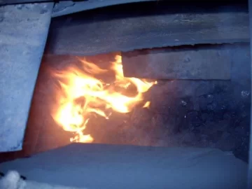

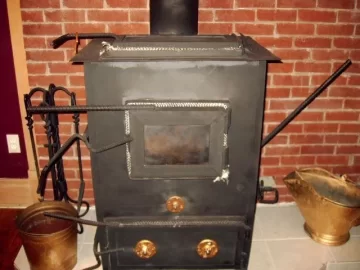

this is a pic of one of my coal stoves, in the dining room, not as pretty as i could have made it, but it burns bituminous coal perfectly to a powder w/ secondary burn. There is NO mess, i would not tolerate dust, debris, etc. as you can see it is sitting on white tile, when i clean it, there is absolutely NO dust, from the coal or the ash period.
the pics are after dumping a fresh bucket of coal; it is just starting to burn.
