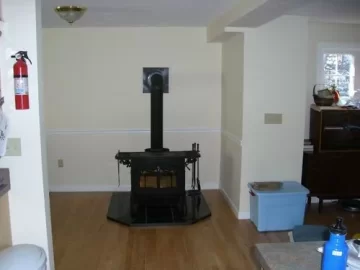

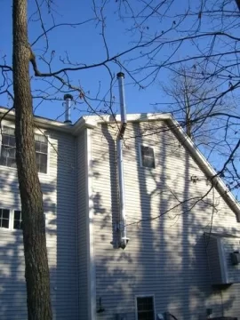

So what kind of chimney/flue and how tall?
I'm not sure of the measurements - I need to get a ladder up there or get the sweep to measure it when we clean it this spring (I'll measure it myself if necessary - I'll be there staring down the pipe if he'll let me near the ladder if you know what I mean, heh). Anyway the setup has double wall SS 6" all the way outside and then through the wall. Inside I have about 4' of single wall up to the bend that goes 90* to meed the SS to go through the wall. If I did the pictures right here you can see the run and perhaps guess the length...
