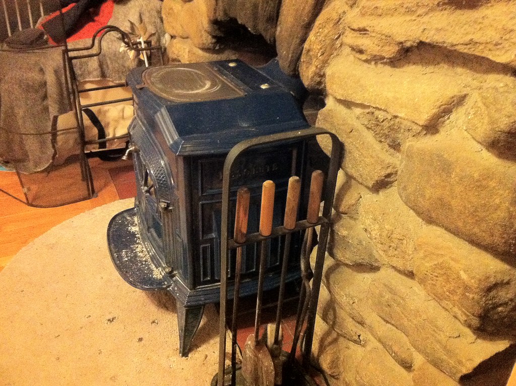

I currently have a VC Resolute woodstove and will be upgrading to a similar style pellet stove. I'm aiming for the largest BTU output I can get away with.
This means I'm looking either a Enviro Empress or M55, a Castile or AE... depending on what fits. The smaller variants will fit no issue but I'd like to consider the larger stoves. The reason being our living room is on the small side and every inch counts.
The VC Resolute is set back in the existing fieldstone fireplace firebox. The larger pellet stoves all might fit with the hopper set in to the fireplace. The cast iron body might be just a couple of inches from the jam/lentil.
Will this fail code or is the fact that it's a fireplace be exempt from clearances?

I see! thanks. All the manufacturer installation notes are for 'combustable' clearances. So I guess I'm good to go wrt to setting the stove I want as close to the lentil/jambs.
fwiw this is the setup I'm replacing and hope to 'fit' a hopper box in to as far as I can.

Just be careful pushing the stove as far back into the opening as possible. On most stoves, the hopper cover hinges on the back and so the door flips up to the rear. You want to be able to open the hopper door and have it stay open without holding it. Not easy to feed and hold the hopper door at the same time.
In th pic, what is the beige colored, half moon shaped material on the floor, in front of and just under the front of the stove?
My son in law (in MA) had a stone hearth extension laid into the wood flooring from his fireplace for a woodstove insert to meet code. Likely could have been something else non-flammable for protection, but the stone matched the fireplace. Looking at your current install I'm surprised this got by inspection in MA with only what appears to be a hearth rug as protection over the edge of a wood floor. Pellet stove insert might be a bit less stringent for regulations of what is needed for floor protection clearance in front of the stove, but it might be worth checking with the local building inspector in case something major needs to be done before an install.
