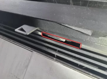

We have our house built with ICF which resulted in a very air tight house. This is the third winter with our FP30 Pacific Energy fireplace and we have all the time this annoying situation when if we open the fireplace to reload and one of the windows or doors in the house is open, the smoke from the fire place is coming aggressively inside the house. I assume no solution for this as the air will follow the most unrestrictive path.
We have a 4" air intake for fireplace so the fireplace takes fresh air from outside but because of that, when the fireplace is not in use a huge cold air draft is coming inside the house from below the fireplace. Looking from where the air is coming, I see is coming through the slot in which the damper lever is running. Anybody have a safe solution to cover that slot somehow and not impede the functionality of the damper lever? The surface is quite hot so need something to not melt/outgas. Also, how to installed as the esthetic grill is right in front of it.

There are a couple of solutions if the outside air duct can be accessed. One is to put a cold trap loop (inverted U) in it. The second is to put an air valve on the outside air.

I had a FP30 installed this past fall and I also had cold air pouring in where the level controls the outside air intake when the weather finally turned cold.
The installer used metal gas flex venting and piped it directly in with a short run less than two feet since the hole was already there from my previous fireplace. The only way to stop it was by blocking it from the outside so it was definitely coming from there.
I removed the metal flex and replaced it with a longer run of insulated flex duct and did the inverted U and that did the trick. When set the air on full high o don’t get any air coming in. If I turn it all the way down I can feel a little air coming in. Not sure why the difference but when not in use I just keep it on full air which would be the case anyway.
Also the new insulated flex does not condensate like the metal flex was doing.
