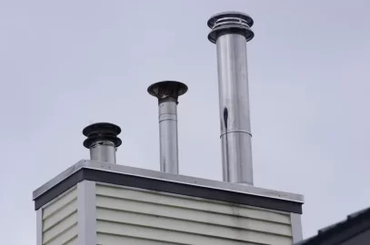

I had the same problem. Smoke from the hot flue was being sucked down the cold (unused) flue and getting into the house. I think the problem is that the cold flue has a negative air flow, meaning air wants to go down rather than up. My 2 flues coming out of the crown of the chimney were almost the same height so the smoke coming out of one flue was being sucked down the other. If you extend the hot flue 6 or 8 inches higher than the unused flue I think the problem will go away. You can do a temporary fix to make sure that it is going to work first.
That's exactly what I had to do. Put another 2ft section on my class a. When they were at the same height had exactly same problem as op

I staggered the chimney heights, with a look to prevailing winds. I think that helped to some degree as well.

edit: Old picture. I've since had the extension of the middle wood insert chimney "double flue-ized".

Usually the chimney heights are set so that the stove (or fireplace) that is lower, say in the basement) has the lower flue. Negative pressure is more apt to happen in the lower stove or fireplace than the upper. It's now always a perfect solution. There are days of very low pressure and calm winds when smoke can sink but usually that is many feet away from the chimney as the smoke cools down.

The main problem your home is experiencing is your home is under negative pressure which is what is causing the smoke to be drawn into your other flue. Here in our neck of the woods, we will extend the main flue that is used higher than the opposite. Make sure your partition separating your flues is intact and not allowing smoke to enter. Another issue that creates this issue would be a running furnace or source which needs to circulate your interior air with a cold air supply which draws air from the path of least resistance which is a open window,door or opening like down a chimney. Another cure for separating the flues would be putting on a Custom Chimney Cap that has a partition between the flues or tiles. This will normally create enough separation to resist a downdraft occurrence. Another concern to be aware of is downdraft occurring due to high winds. This is kind of obvious if things have been overly windy in your area as of late. So if the inspection report is thorough and accurate, it sounds like a issue that can be addressed by your local chimney supply company which should be able to help you with all the above. Best wishes
