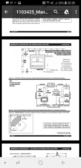

I was wandering can I put up a piece of sheet metal on a 1" furring strip or maybe buy a free standing heat shield to go around the stove. The wall temps get ridiculously high when I have the stove fire going pretty good. I'm at the min right now with min clearance at 8" according to manufacturer specs if I add furring strip it will take that down to 7" would this be ok. I dont really want to move the stove but if i have to i will.
Pic below is my corner installation clearence of min 8"

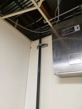

When I saw the Ansul I thought WTH? LOL . Dont give the Gov any more ideas pertaining to wood stove installations.
