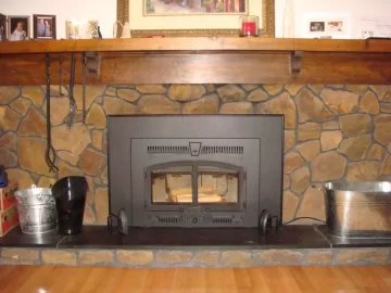

I have the Declaration and love it... It take a 24" log with almost a 3cu ft box and looks nice too! (wife loved the flush look and I liked the big firebox)
  • [Hearth.com] comparison fireplace inserts Lopi, Quadrafire and Jotul
