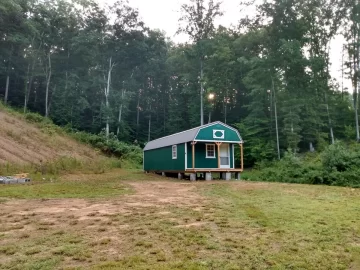

Okay, so I've found myself down a rabbit hole here. We're newly off grid in the mountains of WV, and I would love to procure a wood stove to get us through winter.
My original plan was to purchase new, probably from the local Lowe's or tractor supply. But funds have become incredibly tight suddenly, so I've been on the hunt for a better deal, second hand.
I realistically only need to heat about 600sq ft, although adding on another 200 may be further down the road.. and my preference is for something I can see the fire, too.

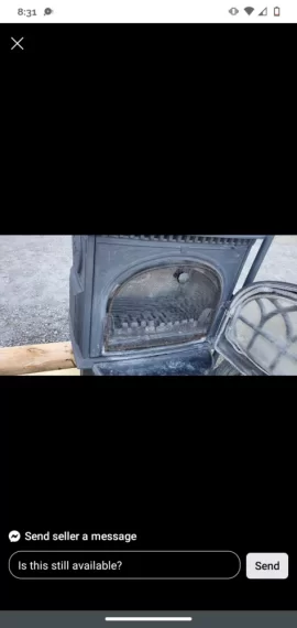

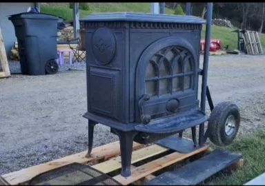

Anywho- I've come across a few different styles, but I've found a Jotul that seems to have caught my eye. (Quite honestly, I may be on the verge of obsession with this brand, but wow they're pricey!) It's a 4 hour drive though. What say you oh knowledgeable people of the hearth? Is this something I can just install, toss a few logs in, and essentially be good to go? I'm currently lost in this rabbit hole, "cats" really threw me for a loop. They're asking $500 for this one, Jotul f3 cb. Decent second hand wood stoves are apparently hard to find around me!

The F3CB is a nice little stove. It will provide 4-5 hr burn times with hardwood, during milder weather. It's fine to add 2-3 splits at a time. The firebox only holds about 4-5.
How well insulated is the cabin? Is there another source of heat? The reason I ask is that parts of WV can get very cold. When temps are in the teens you may find yourselves needing to stoke to stove every 2-3 hrs.

So the cabin has the pink r13 insulation up on walls and ceilings, and foam board insulation under our floor, drywall is not yet currently up though. And skirting, or at least foam boards, is next on our to-do list. Currently our only other sources of heat are a couple of ceramic heaters. We're still running off the generator though, so they don't seem capable of pulling their full force... This is our first winter here, originally from Texas, so not quite sure what to expect, but we are in the more southern area of WV.

I would buy it for that if I did not see any cracks. Price is fair if it’s good shape. The CB in the F3CB is the clean burn model and does not have a catalytic converter. Other F3 models did.

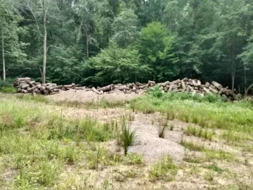

Wood supply, well, our neighbor was kind enough to say we can share his log supply with him. We've already started splitting some.. but I imagine the moisture level is still high. These were felled 3 years ago, but obviously haven't had much done to them since.
Yes it will still be high for sure.

Some of the other F3 models did for a short period, but the original F3 did not. The F3CB was introduced around the early 2000s? Ours was a 2004 model I think.

The F3CB does not do well with >20% wood, trust me, been there. It needs fully seasoned wood for it's brief secondary burn. It will work on a shorter chimney, but should have at least 12' of flue straight up, more if not straight up.

3" thick insulation (R13) in the ceiling is pretty light duty. I would build that up with a layer of 6" on top of the R13 layer.
I just checked the yearly temps for Charlestown, WV. The January average high is 46 and low is 26. Looking back over the past ten years there have been temps in the teens for several years. They might need to open a window during milder weather, but during a cold snap, the stove will be working. I think it will be ok. Better than nothing, as long as it has good dry fuel.
