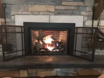

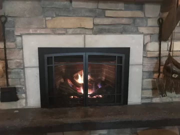

I have a Mendota direct-vent gas insert. We love it! I've done everything in this fireplace from open fires, wood insert, ventless gas log, to this insert. It's awesome, we couldn't be happier with it!

Looks great. Two fireplaces and two stoves? You have a veritable fire palace.
