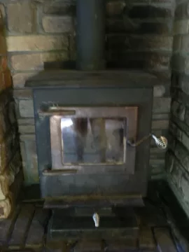

Here's the stove
[Hearth.com] Complete novice here

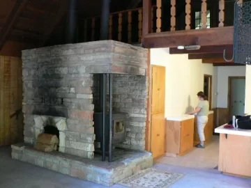

The hearth and view of open loft above

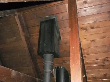

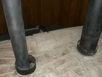

Chimneys

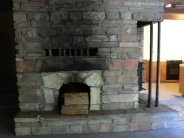

Fireplace
well it is obvious that the fireplace does not work well by the smoke staining above it. As far as the stove I know nothing about that stove so I cant give you much input on it but I can tell you if the cabin is cold especially with that huge mass of masonry (if it is solid masonry which I think is doubtful) it is going to take a long time to get the temp up in there. I would also investigate the construction of that masonry mass because if it is just veneer stove over framing you probably have some clearance issues.
A bigger, more modern heater with a blower should make a nice difference there. Dry wood is essential for good heat. Construction cutoffs are ok, but best mixed with dry cord wood. I'm going to move this post to the main forum. It seems like most of your questions will be about a replacement for the old stove. If so, what is the budget? How tall is the flue from stove top to chimney cap?

How big of a project do you want? Were it me I'd tear the front and sides of the stone down. Just leave back wall and the hearth. Then turn the new stove 90 degrees toward the room. That open fireplace isn't doing anything but robbing heat.

It doesn't appear that the open fireplace is installed correctly anyway. Does it transition to chimney or is it black stove pipe all the way out?

It is black stove pipe all the way. I have no problem sealing it up as much as possible and then leaving it for some sort of decorative use.

The chimneys where they go through the ceiling the one from the stove looks like a ceiling support box, does it transition to class A chimney from there? What type of connecting pipe is it and what sort of clearance does it have to that beam? The one from the open fireplace what type of pipe is that? It looks like it just goes right through and you mention it's 'black stove pipe'. If that's just single wall stovepipe it needs 18"s of clearance and if it is double wall it's likely 6". Also it should mount to a ceiling support box where it would transition to chimney pipe. How is it supported presently?

At this point you really need to get a pro out to look at things in person. But I can tell you if that mass is truly solid masonry it is going to take a very long time to bring the cabin up to temperature. That mass is going to suck up a massive amount of btus. If you were heating 247 with the stove that would be a nice benifit but coming in and trying to heat from cold it is going to be a huge handicap.
What is the purpose of that vent built into the hearth above the body of the main open fireplace?
Trying to get heat into the room off the metal firebox, I'd think.

If it were me, I might think about removing the top and just keeping a portion of the stonework on the bottom as a hearth, and putting a free-standing stove on it...
