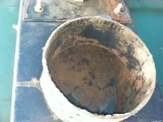

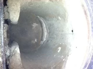

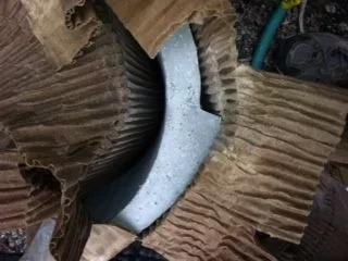

Here are some photos of this Biomass 40 in question.

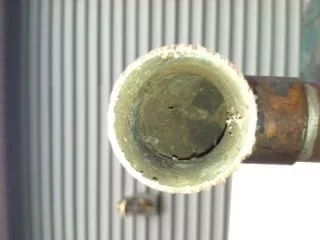

The photo of the interior of the copper tube raises a red flag in my opinion. It appears to have a significant build-up of minerals that would only occur if new water was continuously added to the system. It looks more like a DHW interior. Usually boiler water turns slightly black from conversion of rust and deposits a thin black film on the ID of the pipe and boiler which is easily wiped off with one stroke.

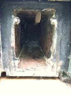

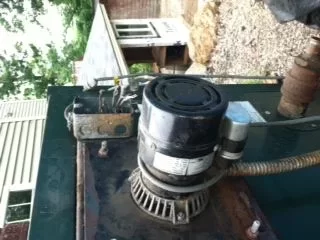

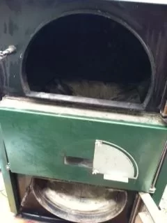

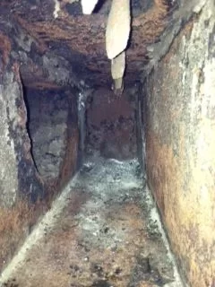

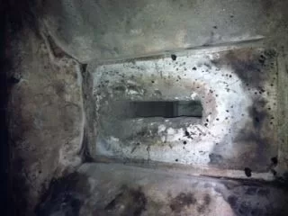

When was it last used? Surprising to see surface rust on the lower chamber and the bottom ash chamber. It implies it's been sitting out in the weather. Exterior door doesn't look too bad so seals weren't totally gone. Lots of surface crud but that's normal and I doubt the frustrated owner was much inclined to clean it much. Nozzle looks like it's shot which is normal wear. You may be luckier than me replacing the nozzle.... Ugly job. I'd say the market is small and if you can't inspect offer 1500 and explain you're taking a big risk. But even at 2k your odds are still pretty good. How much of a risk taker are you? The absolute worst would be to put 25 psi water in it and see it leak. But all else is just replacement parts. It's just like buying a used car... Are you prepared for someone else's problems. But I'll give you better than 80% likelihood you'll be ok. But it's not my money. These boilers are manufactured in Poland by a well respected boiler manufacturer. A good value. I presume you've read thru the BioMass Sticky. Lots of happy and frustrated users. But those that did the right things end up happy. The only thing that would worry me was a leaking pressure vessel. All else just parts. Let us know if you pull the trigger.
BTW, I didn't notice a copper tube. Could be rust. There's no copper in a 60. But I'm looking at pics on my phone.
I see a copper pipe in the last pic - but don't know what it is. Must be fresh feed?
Also agree it looks like it's been sitting a while - quite a bit of surface rust in places. Could use a good cleaning & new nozzle. A pressure test would tell the tale - but I don't think I've ever read of a Biomass with a leak? 5 years isn't really that old for a boiler as long as it was treated OK - mine is 3 years old now & except for one refractory that cracked in the first winter (which I still haven't done a thing about and won't be for the foreseeable future), I see no noticeable signs of deterioration.
I think I'm also now thinking $2k with the rusty pics - and I also think I see some creosote buildup in spots. (Hard to tell for sure...)
EDIT: I also don't see a pic of the area of the top of the tubes/HX - that would be a place that may be subject to lack of maintenance/cleaning issues, I think.
That's correct Maple. There's never been a report of a leaking BioMass on this forum to my knowledge. The current owner appears to have done all the right things regarding corrosion. Poster still hasn't stated why the owner removed it from service.

Is the 8th pic of a "NEW" refractory in cardboard I see? If so may be a decent deal.

Surface rust caught me by surprise. Mine doesn't have any rust like that, but i use it year round too.
Looks like it's been sitting outside a while. Probably not good on the fan.
would also be very hard on the controller and that is a $200 dollar part.
