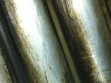

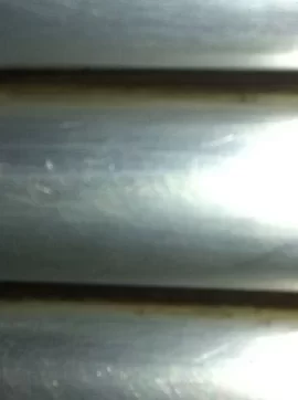

Last week I posted pics of creosote forming on my heat exchanger tubes. The before and after pics are shown below.

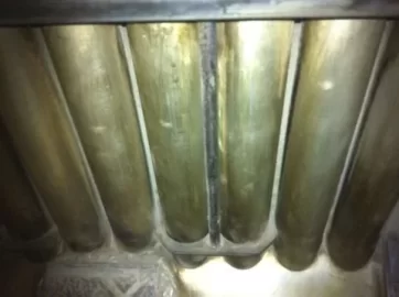

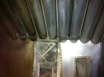

This week I inspected the tubes again. The first pic shows a nice layer of fine ash which I was happy with. However after brushing the ash off the layer of black film was on the tubes again....not as bad as last week but it was still there. See pics.

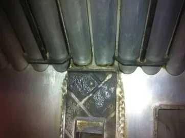

I then cleaned half of the tubes and one rear wall with warm water and soap which came off very easily. The pic shows a major difference between the two sides.

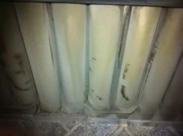

The next pic shows everything cleaned. What is making this black film form. It's not really sticky but tacky. Like I said it comes off very easily with soap and water, however I shouldn't have to keep washing the tubes every week. Any thoughts???

Sticky brown residue usually indicates a creosote problem. Have you been running the stove on low setting for extended periods? Or could be an air path blockage reducing flow through the stove ("rich" air/fuel ratio)? Last time the stove was taken apart and cleaned inside & out??
Have you tried running the stove on high setting for a couple of hours?

The black sticky stuff on the firebrick, where the pellet chute is, also indicates an improper burn. Grey ash should be about the only thing in the firebox. Maybe some brown color on the brick. But definitely not black. The burn is very rich. Even an improper flame height (to big) shouldnt cause that.
Seems there may be another problem. It could be a number of things, but my most likely suggestion would be an air leak, robbing the pot of air.
With your stove, its more important to keep the path clear behind the right firebrick (exhaust). Cleaning that path, along with the combustion blower. Blowing the air to clean behind the tubes will only help with the efficiency of the unit. My stoves exhaust follows the tubes down into the back of the stove (vitally important I keep that area clean).
Have you checked your door gasket yet? Are the 8 little holes (4 front/4 back) in the bottom of the pot clear? How about the gap on the burnpot clean-out? Can you fit a dime in the gap between the pot and the plate? How long is your OAK intake pipe?
Last year I remember some say the OAK was letting high moisture air into the firebox for the burn. Was causing problems with the burn of the stove. Just a thought, seeing how you jist added the OAK. Something has changed.
I will compliment you on how obsessive you are about stove cleanlinless and say I think your expectations are a little bit too high. Comparing your stove to mine makes me LOL.
You're not using a wire brush on the tubes are you??
Anyway, to me it just looks nomal but if something has changed compared to what you're used to the it looks like creosote forming due to a not so good batch of pellets.
I suggest buying a few bags of a different species and testing them out to see how much build-up you get.

Not to get too technical but I am pretty convinced that what you are seeing is normal creosote.
It's the volatile portion (unburned fuel) that sticks to the tubes first followed by the layer of fluffy white ash which prevents more volatiles from further condensing on the heat exchange tubes.
Some different pellets would help......if they are better than the ones you have now. Or they may make it worse. There really isn't anything you need to do at this time unless you want to try some different pellets. And let me just reiterate that when I say better or worse that I don't think you have a problem that requires any addressing.
Let me also just say that you are absolutely obsessed and will fit in well on this site. :)
You may be correct about the normal creosote build up. I was happy to see the fine ash on the tubes. There is nothing more I can do. The stove is running great ....putting out great heat....strong vigorous flames.
And YES I am OBSESSED and do love visiting this site.
I agree...unless it was a black gooey mess you shouldn't worry. It doesn't look that way to me. Looks like normal ash buildup. My tubes are painted black and are steel, so they always look black. I do use a brush and clean around them, but only ash falls off from them. Never do have any creosote. I believe there is a difference between creosote and black ash. I think creosote is kind of shiny in appearance and hard or crusty. I think some people on here mistake black ash for creosote although I'm no expert on the matter.
