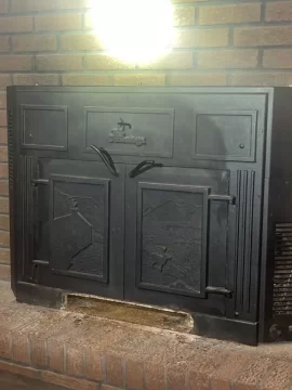

Looking for information on this wood burning stove insert. Having trouble finding much on the brand The Conestoga and was hoping someone has some insight. Had an inspector come through today that was also unsure about the insert..
[Hearth.com] Conestoga Insert
I would have concerns too if this is a slammer install (not connected to a stainless steel liner). That type of installation is no longer allowed.
