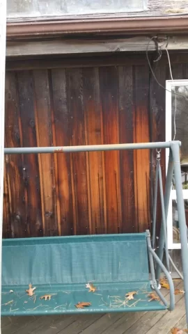

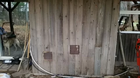

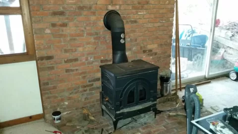

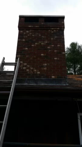

There is a separate chimney for both the stove and the fireplace. The bend is not too far above the thimble so I would probably just come straight out. Here are some pics. Thanks for all the comments.

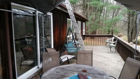

Here is another pic of the deck. An outside pipe would run up where the ladder is. I suppose I might also run it straight under the deck and up the rail but that also seems weird.
Good to know. Do you know where the second bend is above the first? Is it still below the ceiling by at least a foot?
The bends are going around my heatalater fireplace. I think the first one is about ceiling/floor level. The second one goes up the side of the fireplace and there is probably a third one to move the tile back to the being next to the fireplace chimney.
Have you discussed with a good certified sweep the option of tapping in a new thimble at least above the last bend? And possibly locating the point of the second bend (from the basement floor up)?
