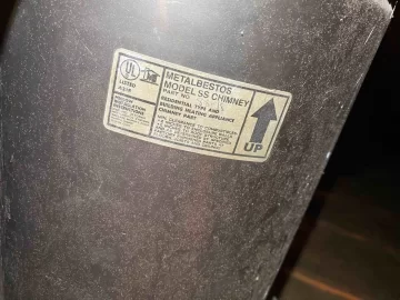

Called Selkirk, asked them basically the same question: how to connect the stove. Spoke with a gentleman named Price in technical support. Notes not in chronological order:
  • Me: I Have Metalbestos SS chimney, B-vent stove, both existing
  • Price: Metalbestos SS was made 70s through 1983
  • Price: at the chimney stop they made two adapters:
    • Stove pipe adapter (about 12" long)
    • Chimney pipe adapter (short and with a crimped end)
  • Price: Single wall pipe doesn't need 18" clearance for gas, gas single-wall pipe only needs 6"
  • Me: Can run b vent from chimney to stove?
  • Price: Yes
    • Connect to stove with b-vent then go up and put increaser at the top, 4" to 8"
    • Low profile increaser would work, 4" to 8", part number is 4rv-i8 product code is 104308
    • Cut down the stove pipe adapter, Then use sheet metal screws to attach the increaser to the adapter
Cutting the stove pipe adapter is a little more hodge-podge than I was hoping for, but after speaking with Price I got the vibe that he knows as much as anyone about this stuff and his instructions will be as safe and as by-the-book as is humanly possible, so I plan to proceed this way.
