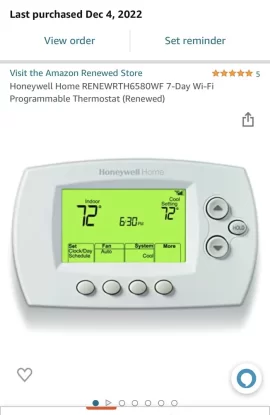

So the issue for me to accomplish this has always been that I wanted to use the same Wi-Fi thermostat (same model, not actually the same physical unit) as what runs the propane forced hot air at my second home.
Mainly for the simplicity of running both thermostats from the same app.

The other issue is that the Wi-Fi thermostat I use requires the “c-wire” from the furnace to supply the power to the thermostat in order for it to function. Since the Englander stove isn’t set up for that, I needed to find a work around for that too

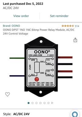

Next I needed to take the signal wire from the thermostat and make it just be a closed switch without sending 24v to the board on the pellet stove. I really wasn’t sure if that would hurt the board, and given that it is just a jumper there for non thermostat operation, I didn’t think it was a good idea to “just try it”. Especially since a new control board was over $300 if I fried it somehow.

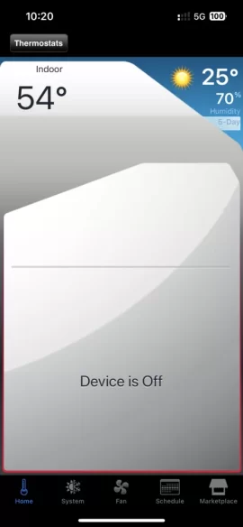

So what I bought instead was this simple relay switch that takes the 24v from the out signal of the thermostat, and converts it to a simple “normally open or normally closed” switch. I connected the wires from the normally open pair, to the jumper leads on the board, so when the thermostat calls for heat, it trips the relay switch with closes the circuit and allows the stove to run.

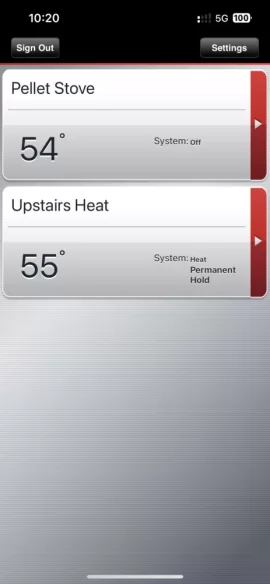

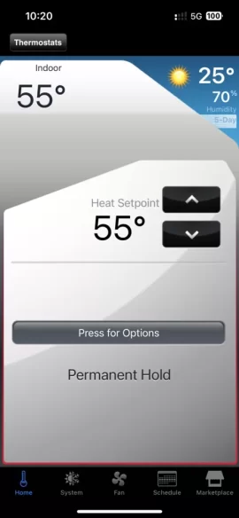

Now the new routine will be, to just leave the pellet stove ready to go with a full hopper, and turn it on early in the day Friday, instead of the propane forced hot air furnace. Give it plenty of time to warm the house before we get there, and I can finally turn it on way ahead of time from my phone.
Really happy with the outcome. I realize it’s not the space shuttle and I didn’t cure world hunger this weekend, but it was a fun project for very little money. I had a spool of thermostat wire on hand already, and the thermostat I bought was half price refurbished for a little over $50, and the relay switch was around $15. I tested it last night before we left to come home. I can remotely start it, and remotely turn it off from anywhere with my iPhone. I did purchase an extra ring camera to so I can visually see that it’s running, and not doing anything crazy.
