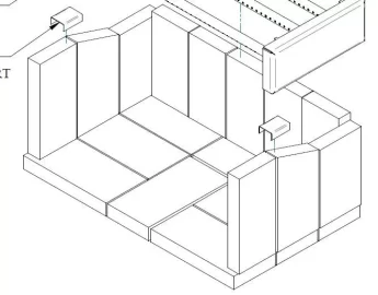

It's definitely low-priced, but with a shallow firebox, how large is it? Based on the firebrick layout I would guess about 1.2 cu ft. Is this big enough to do the job? Maybe.

I saw that spec, then looked at the firebrick layout. The floor of the stove is about 12" x 19.5". Height starts out in the back at 7.5" and goes up to 9". 1.2 cu ft usable firebox is being generous.

Something is amiss with the capacity specs for the CW2500 on Century Heating's website. The firebox dimensions are listed as 20.5" wide x 12.5" deep x 9.0" high yet they show the capacity as 2.0 Cu ft. Either the dimensions are incorrect or 2 Cu ft. is a misprint. Simple math using the firebox dimensions gives a capacity of 1.33 Cu ft. (20.5 x 12.5 x 9.0 = 2306/1728 = 1.33) and this does not take into consideration the height of the firebox is shorter in the back than it is in the front. The Drolet 1400I is listed as a 1.8 Cu Ft. firebox dimensions are 21 x 13 3/4 x 10 7/8 which is slightly bigger than the CW2500. Note, SBI owns both Drolet and Century Heating. I have the Drolet 1400I and while it is somewhat too small for my application it is built like a tank. Note, the Drolet 1400I weighs 350lbs while the CW2500 weighs in at 235 lbs. The CW2500 did very well in the EPA soft wood tests with a BTU of 57,000 most likely due to the thinner metal used on the stove.
The Century stoves have a 3/16" thick top plate where the Drolets have 1/4" for their flat top stoves. Ergo some of the weight difference. And a lesser chance of warping with the Drolet.
I may be missing something, but how can it be 20.5" wide with two 1.5" bricks sitting on top of the floor bricks? 9+9+4.5-3= 19.5"

Thanks for bringing that up to our attention guys. CFM marketing use to state Cu Ft without bricks. We never changed the specs in the Lit when we bought the company.
We will be changing them to reflect the true specs. CW2500 is actually 1.44 Cu Ft.
