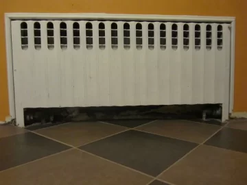

I recently bought a 1953 cape here in CT that's about 1600 sq/ft. It has the original oil boiler which is probably running at about 60% efficiency based on how much oil I'm burning. My plumber put a Newmac furnace in his house and recommended a Newmac BC 160-0115 boiler to me. I need to replace this old clunker before heating season one way or another. I have recessed cast iron radiators that are hot water, not steam. It makes sense to me that water + cast iron would work well with wood as a fuel (better than hot air, or even modern water radiators). So is this situation ideal for a wood boiler?

Hard to beat the heating system you've got now with those rads. Definitely incorporate storage if at all possible - it's a bigger game changer than going to a gassifier is, IMO, as long as the boiler has good heat transfer, which this one should with the fire tubes.
