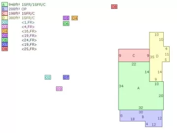

My bad! Here's the information on my home from the auditor's site (check out the date built. We're only able to guesstimate from the dates on the hardware and some newspapers we found in the attic!)
No. of Stories: 2.00
Finished Square Footage: 2474
Year Built: Old
Here's a basic image of the house from their site as well.

From the diagram it looks like the core of the house is about 1100 sq ft per floor. Is that correct? Are the other areas, porch, mudrooms and the like? From the looks of things, I think the T6 would work fine for you. If you have a great local dealer that is even better. Sounds like you'll need to extend the hearth to accommodate the stove. Can you post a picture of the current fireplace?

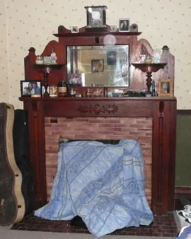

Here's a picture of the mantle/hearth/etc. Ignore the blanket, it's blocking the opening. We have a hell of a draft from there!
The plan is to pull up all of the tile, pull the mantle out and see how much room we can really get in there to put the stove in and make it fit. We're not going to be able to have tons of space for clearance, but we'll do whatever we need to.

The PE Alderleas have close clearances. I think without the mantle you'll be fine. You will need to build a proper hearth, but that is not a big deal. Where on the diagram is the current fireplace? Interior or exterior chimney?
