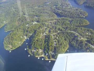

Here is a photo of the area I am building the house. It's in Moore county 10 miles from Lynchburg, TN.
The house is built like a hardened bunker. At the max point about five feet below grade, All block is filled with rebar and concrete. All interior framing is non structural. I put the side walls with two fours flat and back wall with them normal because much wiring will be here. I was able to buy a large quantity of 2 1/2 and 1 1/2 inch polyiso from commercial roofers for pennies on the dollar. Coupled with some blue XPS to flush out the needed dimensions I will have as previously mentioned R35 in walls and R 60 in ceiling. I took this aerial shot. I have only a limited lake view but otherwise a nice lot. Most of the water front lots are extremely steep and expensive to buy and to build on.
