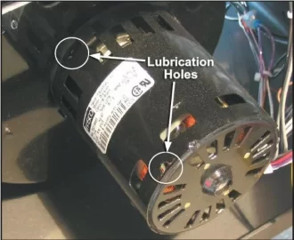

If you look all around the unit, do you see any ports like these? If you do, they are the oiling ports. Put 2-3 drops of "3 in 1" oil, or any non-detergent 20w

Even if you don't see those ports as imacman pointed out. Do you see the open bearing on the end of the motor that imacman posted? A couple drops in that area will allow the bearing to "suck" some in. Also, if you can "drop" some carefully on the front bearing, do so also.
They may be sealed... But they are are not sealed solid. It's a dust cover that has clearance around the edges.

Thanks Mac, There were only 2 ports. I am going to put it back in and try it.
