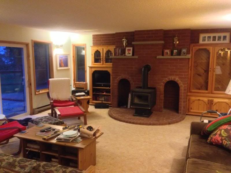

This is an idea I'm toying with for the future, and yes I know this is opposite from the usual scenario, but has anyone converted a masonry hearth/chimney with a freestanding stove to accept an insert? I'm going to renovate the living room in the future and also the hearth area. I was thinking about saving some space with a flush mounted insert but no idea how crazy of a job this would be. The arched storage areas are 18 inches deep and the actual chimney extends to the base of the hearth and there is an old clean out there (hidden behind pedestal in pics). So it's already partially hollow behind the stove and I'm pretty sure I have the space for an insert. The other thing is that I have a short chimney and an insert would eliminate the 2 90 degree bends I have (elbow and the tee section) so I could go straight up and have better draft. Plus I gain additional floor space and like the clean look of the flush insert.
Here's a few pics:
[Hearth.com] Convert freestanding stove to insert?
When you say "masonry hearth" do you mean a masonry fireplace? Could you maybe post some pics? That should help tremendously.
I dunno - this is of course no help to you, but IMHO there's so much character there now - not sure I would change a thing.
I dunno, I have these photos saved from when you originally posted them, because this is one of the nicest looking settings for a freestanding woodstove I've ever seen. This was designed by an artist. And you want to tear out the niches and the semicircular hearth and put in a fireplace, with an insert which won't heat as well. Each to their own taste.
I suppose it could be done with enough money, but with such an elegant set up for your stove it would be a shame to mess with such a beauty.
If you put a soapstone stove there I promise to come back to this thread and sit here in utter, unmitigated envy. (We are in the early planning stages for a soapstone stove in the house to which we hope to retire.)
That's a gorgeous hearth.
Redo the whole room. Leave the hearth. :)

Thanks for the pics; that is really an "one-of-a-kind" hearth setup. I am wondering, too, whether just putting a nicer stove there in cast-iron or soapstone will improve the look of it. Or changing the whole setup to a custom-made masonry heater?! Just dreaming. :)
Anyway, I think it would be good to first get a (chimney-) mason in to evaluate whether your plan of just putting a big hole and base for the insert behind the stove works. It may interfere with the structural integrity of the chimney. Then I would probably wait until spring, remove the stove and do some photoshopping of inserts in there to see if the look is really what you want. I have the feeling an arched insert may work best like this one: http://www.fireplacex.com/ProductGuide/ProductDetail.aspx?modelsku=99800177
In the same way you can also look if another stove (T5 Alderlea, maybe?) will already improve the hearth enough for your taste. Worst case, you can just put the Super back there.
I am curious how it will pan out. Please keep us posted if you do any changes.
If it were possible, and not compromise the structural integrity of the masonry, I would put a nice flush insert higher up say 2' to 3' high. Would look cool with the insert appearing to float up on the wall.

If it were mine and I had to make more floor space. I would have the mason put a third arch between the two you have now and place the new stove in the cavity. Replacing your currant free standing stove for one that is built to be an insert or a freestanding stove, so the projection of heat is more forward. Codes are to constables. A wood stove/insert can touch brick and still meet code.
My insert/freestanding stove sits back in the old fireplace fire box with the damper/smoke shelf removed. The chimney liner is going almost straight up. With all the thermal mass around the stove it heats even past the fire, I haven't felt the need to ever use a fan as most on this site with inserts do.

I called a local stove shop (very reputable place) and talked to them about what I wanted to do (above) and what my options are. First they said the same as some of you already - get a mason in there to look at things - admittedly I have not done this yet but it's in the works. Basically they told me that with regard to selling my house, I can't really use an insert because someone might expect an actual fireplace to be there if the insert was removed? As I said in my first post - I want to flush mount an insert or ZC FP at the bottom of the chimney. They told me I could definitely put a ZC fireplace there (like the PE FP30) but not an insert. I said I didn't care about the fireplace resale thing because I would simply disclose it if I ever sell. But they said it still might not work for building code..anyone ever hear of this? They did say that an insert is designed to be put in a fireplace with brick behind and on all sides and no combustibles....and I was trying to say that's what i would have if I had a mason open up a hole! Of course I understand that a zero clearance is insulated and would be more suitable....and please don't get me wrong I'm not opposed to the zero clearance thing either. It's just a money thing to be honest....insert is much cheaper. Any further thoughts? Or maybe I'm missing something?
I do know that around here when you sell a house you end up having to bring things up to building code compliance. My neighbor has been trying to bring his 30 years of DIY stuff up to where he can put his house on the market for a year now. While making two house payments.
Thanks BB - I talked to my local dealer again and a fireplace insert is "certified for installation in an existing code compliant fireplace"...which I don't have so the insert idea is out. I still like the look of a ZC model the best but this requires a really big reno plus I'll get better heating from a freestanding and the ability for more heat when the power goes out. So at this point I'm having the structure looked at to see if we can create some type of alcove for the stove and still get it moved back and out of the room a bit, then we can upgrade stoves in the future to something that fits the decor better when we reno the living room.
