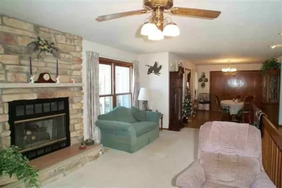

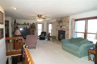

What I see in the pictures is a prefab wood fireplace with a gas log in it. You can easily remove the gas log and then burn wood. It will not be efficient at all. If you want to heat with wood you would have to do a wood insert or remove the entire things and install a built in EPA approved unit. We did 3 jobs last month were we removed an old wood unit like that and put in a new one with all new stone hearth and mantle. You would be looking at around $10k for a project like that. A wood insert would come in around half that, but not as big of a firebox.

Sure you could move it, you would save the cost of the stove and pipe, which is most of the expense. I would be concerned with whats left behind in the old house (holes).
If you are able to heat the house well with the IR, we could always do a gas insert in that prefab, or you could remove the gas logs and just use it for "fun" wood fires to sit around and enjoy.

Its possibly safe, probably not installed fully correctly. Damper should be locked fully open 100% of the time, most of the time this is not done. This is a huge heat loss potential even when not in use. And when you do use it... well its a giant hole and a giant flue with a draft going up it. That air it sucks up the flue comes from somewhere. If you are comparing the flame of an efficient gas insert to that of a furnace I would have to say you are very wrong. Now maybe you are just metaphorically comparing to a furnace, in which case it makes sense.
It could be removed and re-installed at a different location, the labor charges should easily come in at less than the cost just a new stove, not to mention a new chimney. Some chimney components might get damaged but most should be salvageable. You would also have the option of removing just the stove, and leaving the chimney. The new homeowners could get their own stove to attach, or even do a gas stove.
