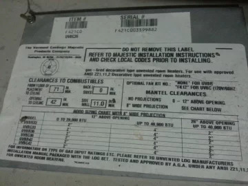

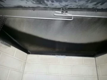

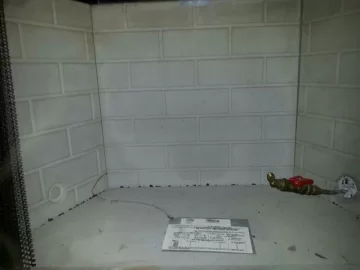

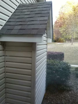

Okay. Sorry it took so long. Here are the pictures. I took a picture of the little plaque on the inside, the inside of the fireplace, the exterior and tried getting a picture above the fireplace looking into the "chimney". I don't think that is even considered a chimney. It doesn't go up past the roof of the house. Also the "brick" inside is not real brick. I think it is a ventless gas insert. So I'm guessing the entire thing would have to be rebuilt? :(

From your photos, the location previously had a Vermont Castings UVBC36: Majestic Fireplace - circulating model.
According to the manual found here: (broken link removed) it is a ventless firebox used for ventless gas logs.
I'm not an expert, but consider this a 'closet' and you will need to assess options for providing a wood burning appliance in a situation such as this. Possibly some direct vent option but who knows about clearances to combustibles until you look at options and study the manuals.

Yeah I figured the whole thing would have to be torn out and an actual brick chimney built. Who installs a gas fireplace in the country!?!?! ugh. I've been calling around to different contractors with no luck. Most of them say they don't do fireplaces. :(
You don't have to have a brick chimney for a wood burning fireplace. You can install a double wall stainless steel pipe, I would imagine that a wood stove pipe would work fine and if I am wrong someone will straighten me out quickly.
You are basically right but it is insulated class a double wall is connecter pipe. There are lots of different options as far as prefab units that use class a chimney from cheap builders boxes that do nothing to contribute heat to modern epa tested zeroclearance stoves
