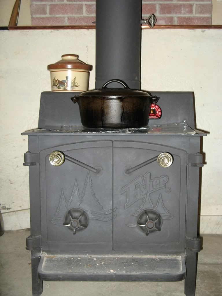

Hope nobody minds that I've shared these here before. I'll have to update the pics, apparently haven't taken one with food on or in the stove since I moved to the NC-30. This is from a few years back when I still had the fisher.
The stove may change, but this dutch oven won't :coolsmirk: Things like chili (chicken or beef) is another good choice for easy wood stove cooking. Also things like short ribs (beef) or country style pork ribs either bbq or w/ sauerkraut, or Kielbasa and kraut, also what I call a "boiled dinner" with left over ham cubes, the ham bone, rutabaga, carrots, potato, and cabbage, etc, etc. Lots of options.

This was pot roast.
I also have a box of salt that I use exclusively for cooking (not adding to the food, but for cooking on). I'll throw 3/4 to an 1 inch of kosher salt in the bottom of the dutch oven and then bake potatoes in there on that salt. Depending on how hard the stove is running, I'll sometimes do it on top, sometimes inside.
pen

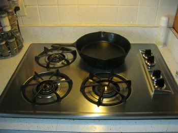

Standard 10 inch skillet on the range

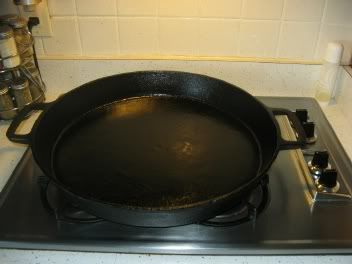

Here is what I affectionately call "panzilla" on the range after getting it seasoned.
