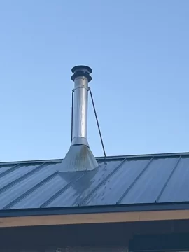

Another question, now that we’ve been running the stove for a few weeks straight, I noticed what looks like creosote staining running down the pipe outside and onto the roof flashing. It’s been brutally windy and cold the last few days. Should I be concerned about this? I couldn’t get any better pictures from the ground, might have to zoom in to see better.

Probably water vapor from combustion condensing on the cap with cold air and wind cooling the cap.
The liquid is pyroligeneous acid, harmless in liquid form. Primarily wood alcohol and acetic acid. When allowed to bake on flue walls this becomes the various stages of creosote.
This is why the internal flue temperature needs to remain above 250f to the top while smoke particles are present. Cooling below condensing temperature is normal with windy conditions blowing through cap opening.
To give you an idea of how much water vapor the chimney needs to carry out, oven dry wood contains 6% hydrogen molecules. The molecular weight ratio of hydrogen to water is 9. So 6% or .06 X 9 = .54 pounds water formed for every pound of oven dry wood consumed. 25% moisture content adds another 1/4 pound of water for every pound of fuel added.
Flue temperature is only critical while smoke particles are present. It can drop during the coaling stage, or when consuming particulate with secondary or catalytic combustion.
This is why the stove and chimney needs to be up to temperature before circulating exhaust around the oven 100% extracting too much heat needed to prevent condensing the water vapor.
