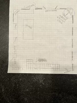

Not to scale drawing, but generally in the ball park. The darker marks on the perimeter are windows.

Pics of the space will greatly help. Drawings are ok but with pics guys/girls here can see potential problems/solutions.
