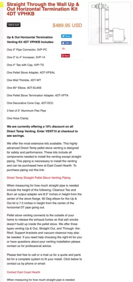

So, I'm new . I'm ordering a Pellet stove next week from Comfortbilt. I'm getting a pad and stove. Been looking at different ways of venting. It's going to be in a corner with a corner pad. On first level of my house. House does have a basement. I want to vent through an appliance adapter, a 45, 12 inch piece, thought the thimble, then horizontal cap,In venting options I see, directly through the wall, up and out and up, and through the wall and up. Wondering which way to go? I will bo going through Sheetrock in the inside then that part of the outside of my house is stucco,concrete gravel. Looking to buy a venting kit, but I see some folks just venting directly out, which i would prefer. Nothing on that side of the house and would be 3 feet from the ground. Is it necessary to have a T clean out and then go up with vent tube then horizontal cap? what benefit is there? I read something about loosing power and allowing fro a natural draft so house doesn't fill up with smoke.Hence going up and out and up. I wanted it to look clean with just horizontal vent pipe through the wall..

Going straight out the back is the best and easiest except if you loose power. then you can get smoke in the house. So how often do you loose power? If it is very seldom I wouldn't be concerned. If you loose power fairly often you might consider either going vertical about 4 feet to create a slight draft to hopefully suck out the smoke or simply buy a converter from 12 volt to 110 and have it hooked up to a 12 volt battery so the stove will keep running. We have had power outages a few times . and yeah no fun getting smoke in the house if you are home you could spray some water into the fire pot and put the fire out then empty the ash container. Pellets will smolder a long time making a lot of smoke so its best to put the fire out right away if possible.
Selkirk DT pellet vent is the most efficient for me!
  • [Hearth.com] Correct pellet stove venting? New Pellet stove!!
